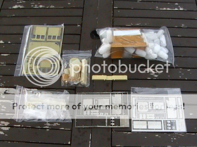

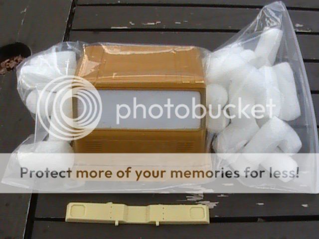

I wonder what is in the Box ???????

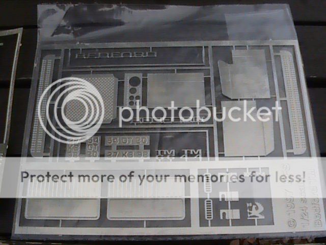

It is the Cab and parts for the Bedford TM that Howard Whitehead of Kit Form Services sold me a long while ago !!!!!!! From what I remember, Howard gave me his last copy and bits available from the run he did.
Having wanted a model of this truck I got to drive in the TA to build, I was only too glad to get what I could from KFS knowing full well that any re-run of the kit might be a long time off, if ever at all.
Howard gave me what he could at the time, and I am grateful to him for that.

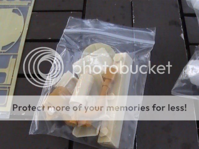

No instructions though, so I think I am going to have fun guessing the parts from comparing with an Army parts manual on the TM that a friend has just provided me with.
Thanks Neil for your help. Information will be a great help on this one.
I haven't opened the bags, but I can see that there is a good selection that will make my life a bit easier
Since the info I have is mainly on the 4X4 Eight Tonne, it is likely that I will go for that, although, if I can source seven wheels and tires of the right size, I might be persuaded to go for the 6X6 Fourteen Tonne.

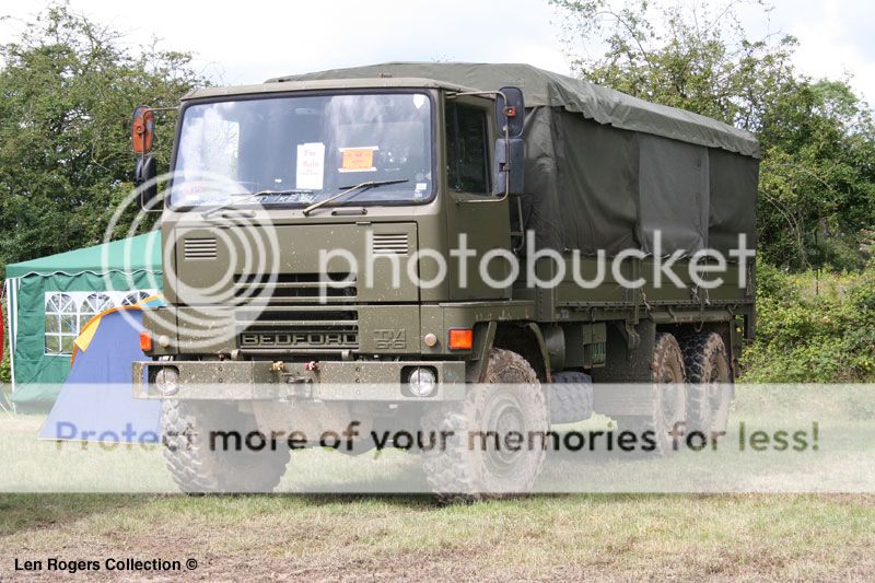

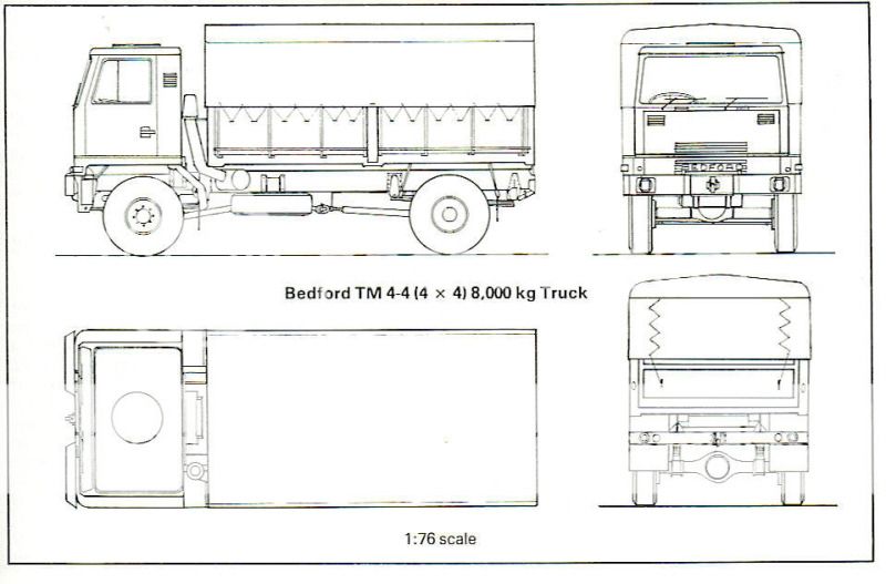

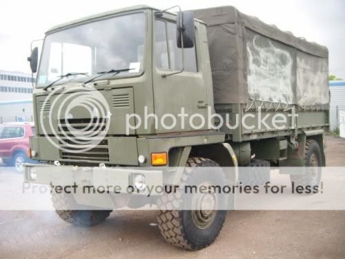

And this is what I hope it will look like at the end
and

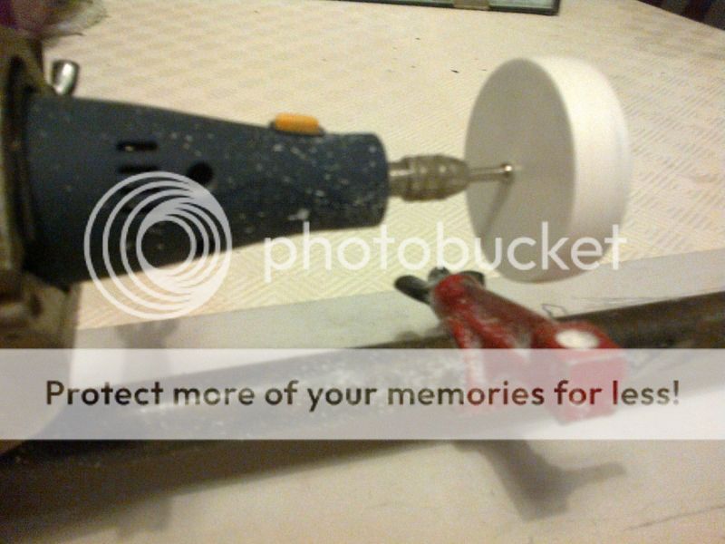

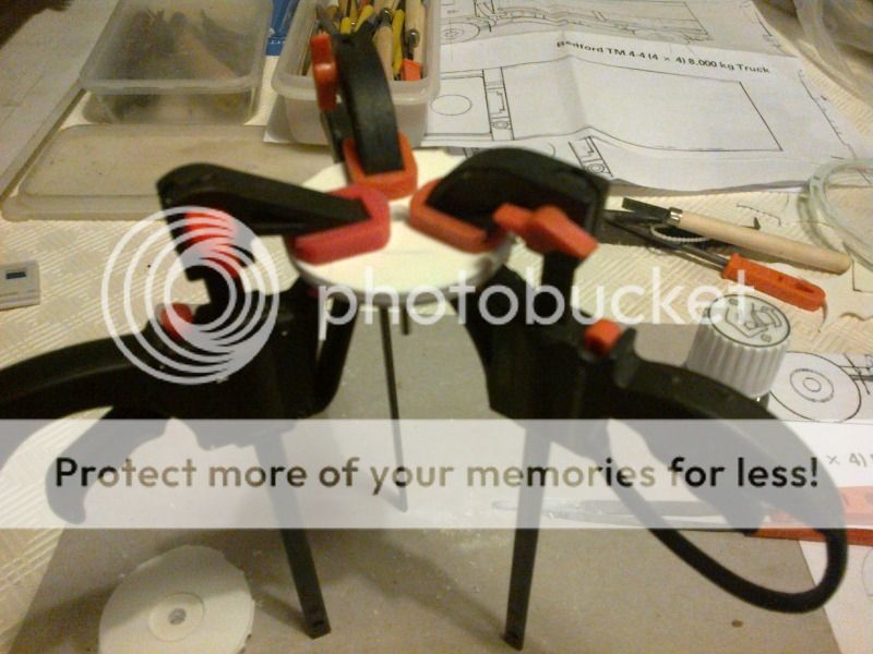

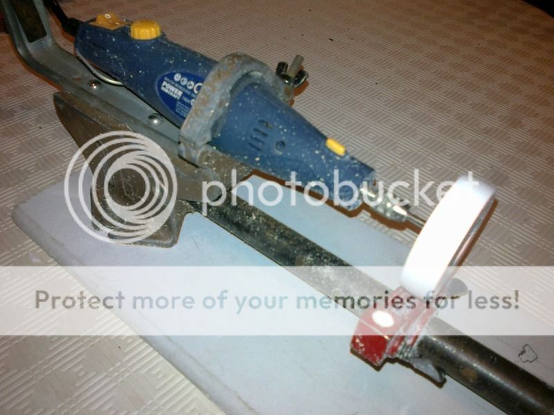

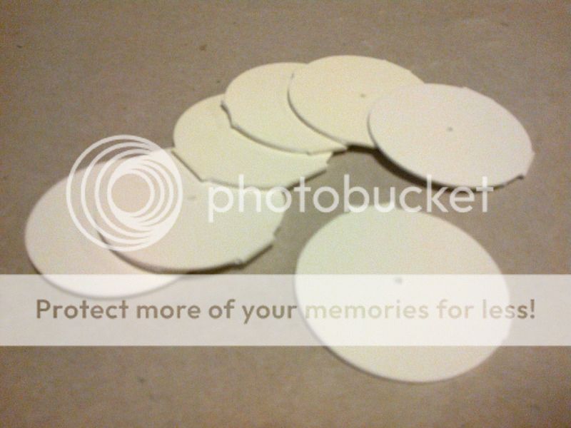

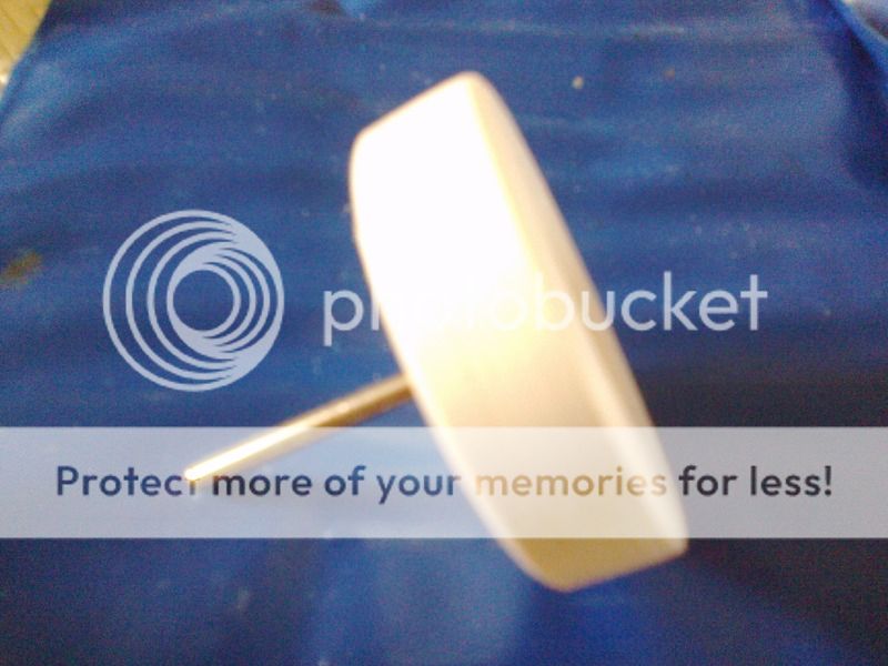

Have made a start on my first ever attempt at scratchbuilding a wheel and tire so wish me luck !!!!!!!!!!!!!!

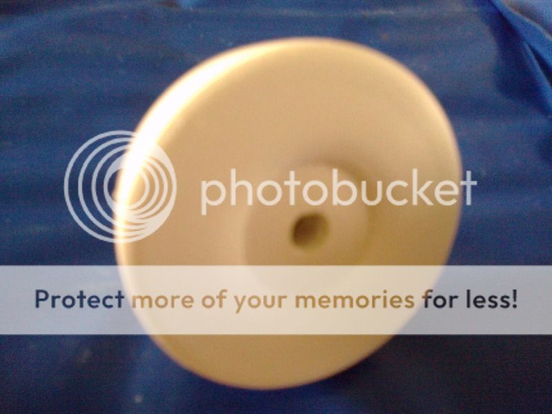

It does help if you get the diameter right, but I think I used one of my photocopies that had a bit over large and I am putting this down to rushing to prepare for the model club night.
So this one is going to be a practice piece that I am going to keep shaving and sanding down to the tread size. I am then going to try my pyrograve on it for the tread pattern. If it proves to be a problem I will sand it beyond the tread and try the add on method instead.
Will be a long process, but hopefully worth it !!!!

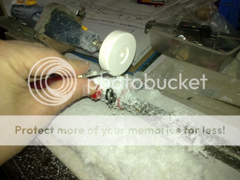

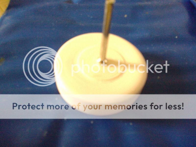

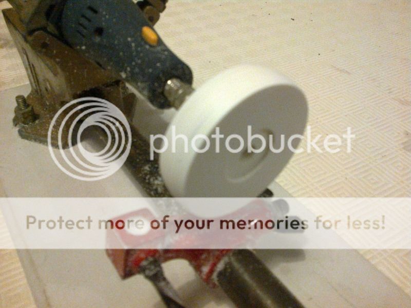

That is the blank formed and ready for some setting out of the tread. Had a snow storm with the amount of plastic I had to shed first. Note to self get the basic diameter a bit closer next time !!!!!!!!!!!!
So far this process has been far easier than I thought and really quite therapeutic.
Will try to mark it out tomorrow and make a start with the pyrograve !!!!!!!!!!!!!!

Another great project, I´m looking forward to another great model. The cab and the PE-parts seems to be high quality, so I´m sure your result also will :ok:
Good work on the tires so far, not easy wjit this kind of lathe.

I have been marking out the tread pattern on the tire blank and am waiting the kettle boiling for a cuppa before setting about engraving the pattern with either pyrograve, drill tools or a combination still to be decided !!!!!!!!!!!
Here is where I got to so far !!!!!!!!!!!!
Coffee, some shortbread and a break to get my head ready for carving !!!!!!

Well Plan A did not work too well as the etching tool on the mini drill was too wide and too rough to etch clean, narrow troughs. I knew I had to try it out simply to know what the limitations of the etching tool are when doing such fine work !!!!!!!!!!!
As I said though, this piece is very much a practice piece and I have been able to simply carve away the tread and reduce the diameter of the blank so that I can now try Plan B ,,,,,,,,,,,,,, adding the nubs to a flat strip in the right pattern and hopefully get a nice even tread !!!!!!!!!!!!

Well this is Plan B started !!!!!!!!!!! And it does help if you have 32 nubs like the original, not 28 as I had miss-calculated on the blank before !!!!!!!!!!!! Measure twice, cut once (or drill,,,,,,,,,,,, or sand ,,,,,,,,,,,,,or whatever) !!!!!!!!!!!!!!
360 divided by 32 equals 11.25 degrees per nub !!!!!!!!!!!!!!
Setting out by angle proved far more accurate than trying to set out with a compass around the circumference !!!!!!!!! Lesson learned !!!!!!!
Using a black piece of sprue, I cut the inner nubs out using my multi-angle guillotine with a necessary adaption of a catchers mitt (a clear sandwich bag weighted down inside) to catch the cut nibs before they can become carpet fodder !!!!!!!
To see the size of cut I wanted to make, I added a sheet of white paper with a very basic measure drawn on it !!!!! I would love to add a more substantial butt stop and measure gauge and would be interested to see what others have maybe added to theirs !!!!!!!!
Adding the nubs to the blank was very easy and quick to get the pattern !!!!!!! The outer nubs have still to be designed and cut, but that will be another day !!!!!!!!!!!!!!
I have made the nibs much larger than needed so that I can gently sand them down all together to the finished tread depth !!!!!! Not sure if to sand them with a slight oversize so that there is less risk of resin shrinkage on the treads !!!!!!!!!!! What do the folks who cast regularly think on this proposal ?????????????

Here is where I am at with the blank so far
All the nubs are as good as this, but I am happy so far.
Just another 32 to do for the inner side wall !!!!!!!!!!!!!

Well I got some progress on the tire and I am quite chuffed with my first attempt !!!!!!!!!! Is not perfect, but I am not a perfectionist by any stroke of the imagination !!!!!!
I will chuck some lines on it for the side wall beading and cross banding. Will need to figure out how to add the lettering and tire sizing figures. I fancy buying some tiny etched brass numbers and letters but will see how the pennies go.
Hope you like
Nige

A bit of faffing about trying to get the side wall banding and lettering. Had a couple of total disasters that had me sanding back a couple of times. Main problem was oversizing of the lettering.
Here is where it is at now.
Hand cut letters
Dunno if I am happy yet though !!!!!!!! Not sure how much detail will be kept when the master is cast !!!!!!!

for the tyre you did a fine modelling job, but the letters are a little bit to ... I don't know how to describe, perhaps is "fuzzy" the best word? What I'm trying to say is, that I think you can do better, more sharper, letters. Take a look at this guy here. In his shop he got self-adhesive letters in several sizes too. I can imagine that these letters, fixed on something like sheet, may give a better look.
Nevertheless, good job (did I already mentioned that?)!!! :ok: Go on Man, you' ll make it!
