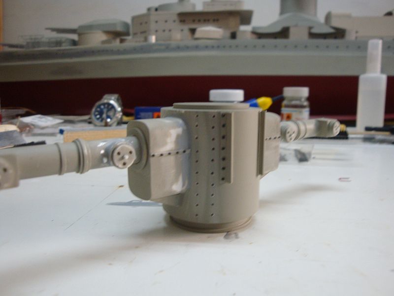

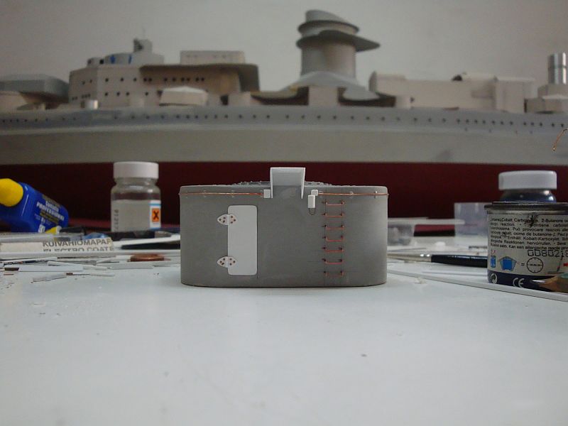

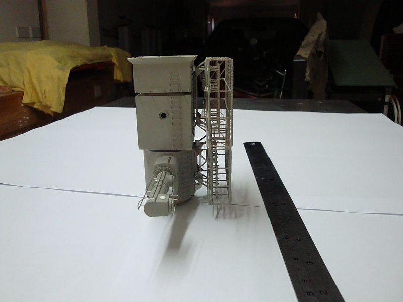

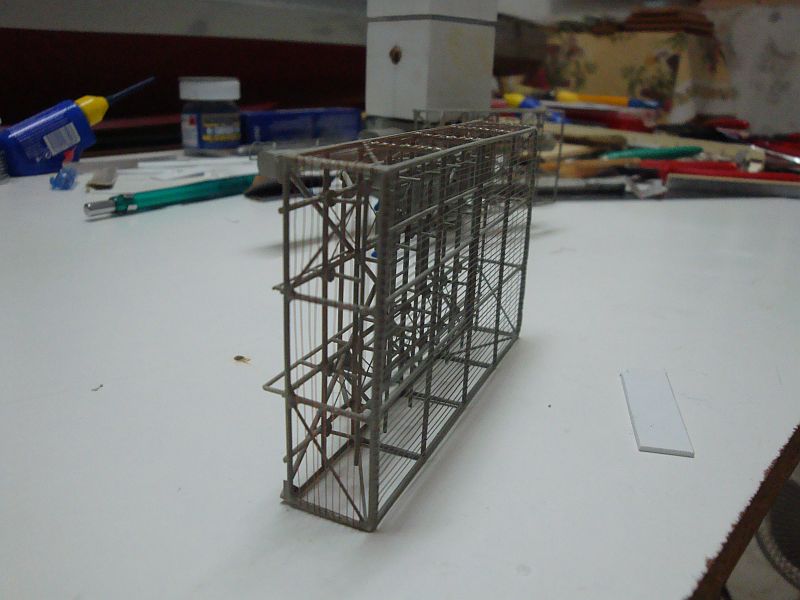

I am now posting the second part of the range finder assembly. :wink:

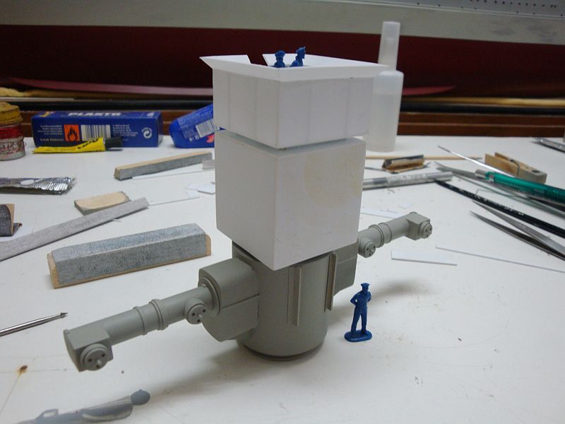

The range finder assembly with some 1:72 scale figures for appreciation of scale.

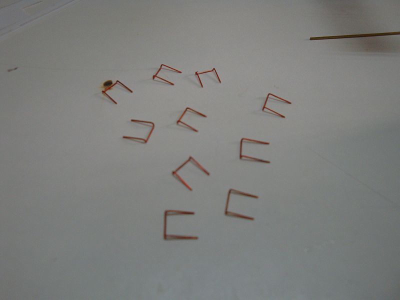

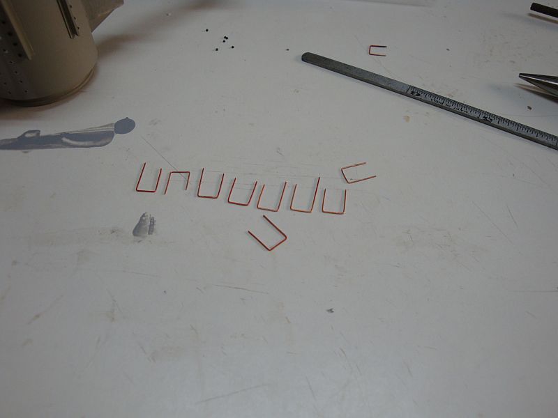

0.3mm diameter copper wire for the range finder access ladder.
Holes for the access ladder steps drilled in the aluminium housing. Note also the rivets.
The first step to forming the access steps.
The second step.
The set of access steps.
The access steps in place.
The first radar in place, the FuMB 4 SAMOS Radar.
A rear view showing the rear detail.
The final wire meshes on the FuMO 27 Radar.
More copper wire pieces for another set of access steps.
Forming the steps.
The final touch.

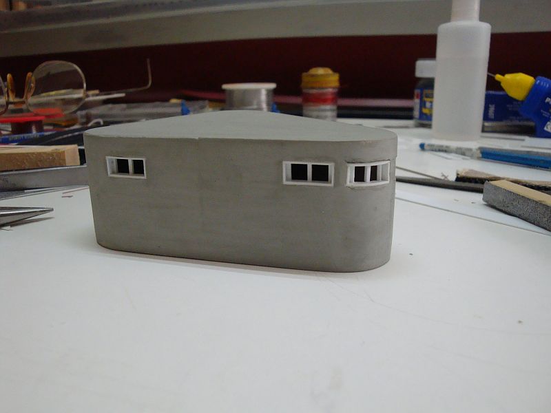

Armoured windows.

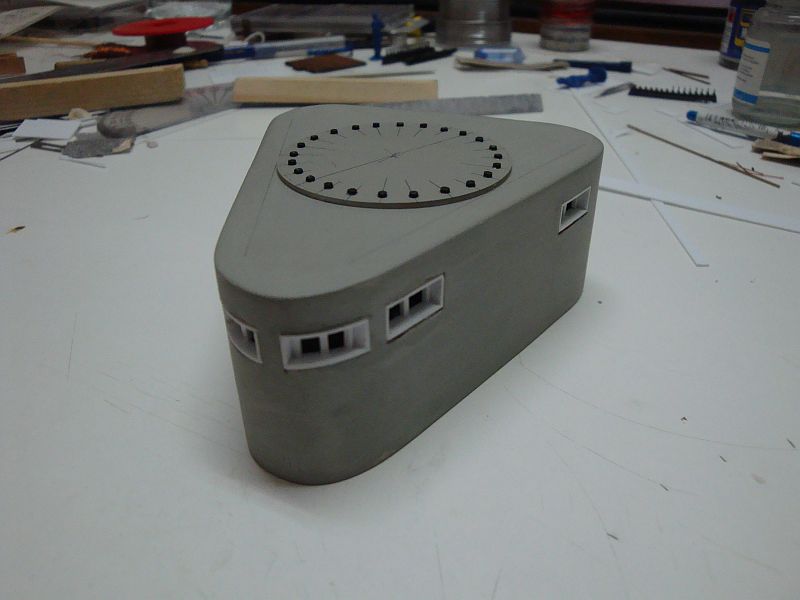

The armoured observation post, which serves as a base for the range finder.

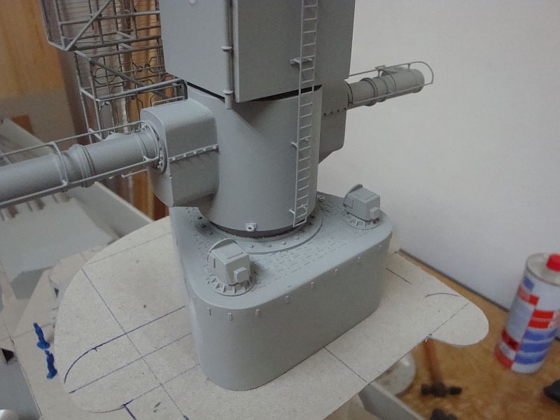

The mounting platform for the range finder.
The whole assembly.

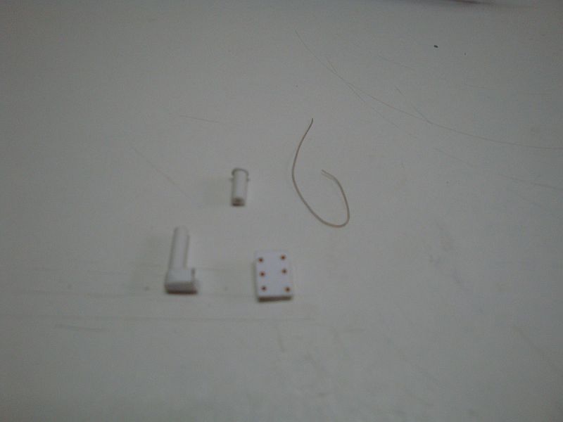

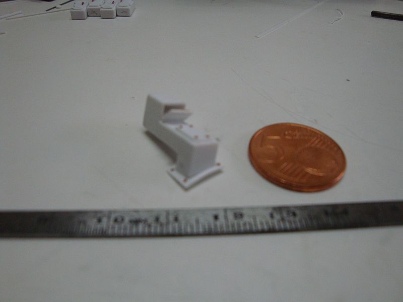

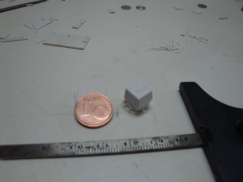

The parts forming part of the FuMB 4 SAMOS radar stabilizer.
Another view of the same parts.
Comparison of size with a 5cent coin.

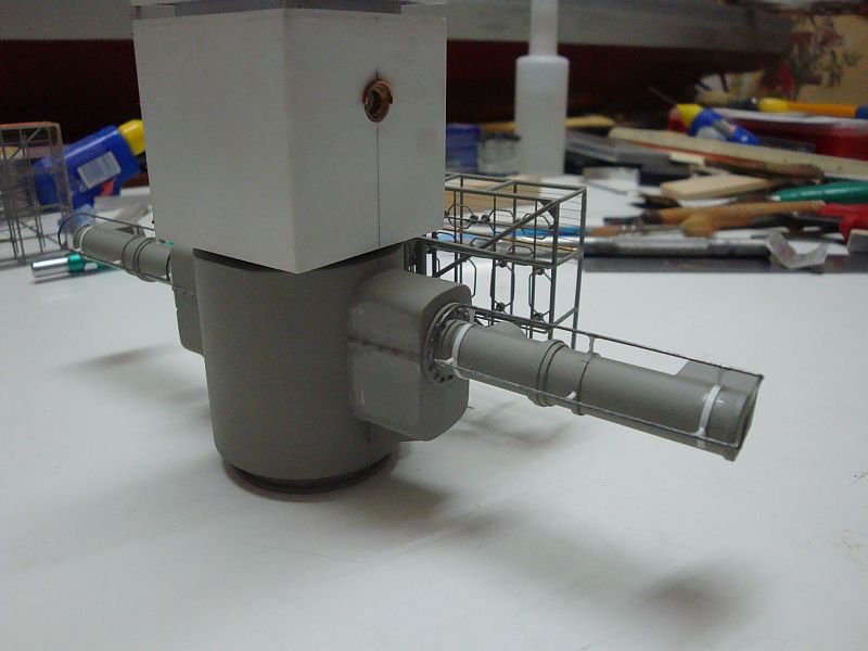

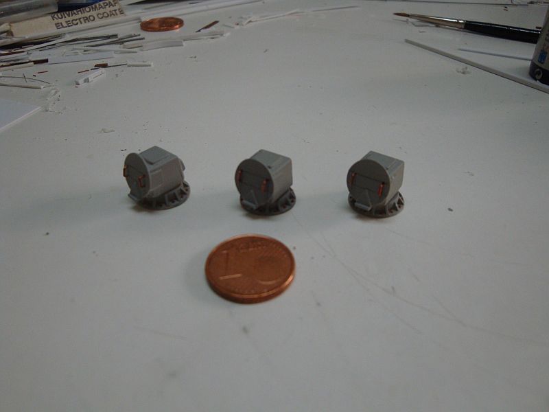

The motor acturator housings. These operated arm link to rotate armoured shields, when the range finder lens were not in use.

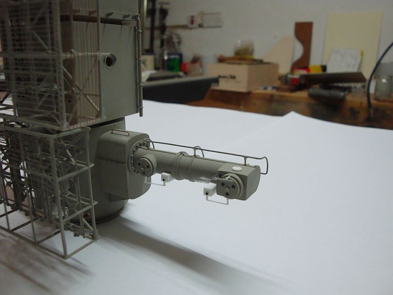

The radars assembled in place and the lens operating arms in place as well.
A side view.
A picture showing the surge arrestor and pneumatic stabilizer for the FuMO 27 Radar.
A close up on the detail.
A close up of the detail on the other side.
The locking crown for the range finder assembly.

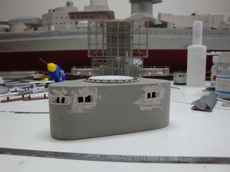

The locking crown in place
Filling the gaps, prior to sanding.
The rear access ladder fitted in.

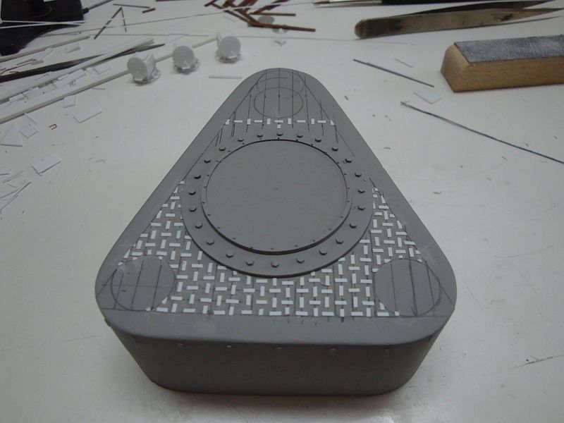

Mittwoch, 26. September 2012, 14:05
Scharnhorst
Good afternoon all, :schrei:
Please excuse me for my long absence, I was a bit busy with other things and now I shall post more pictures related to the progress on the radar installation.
The work on the storage cabintets to be installed in the open observation post.
The same cabinets with details added on.
The cabinets with the locking handles in place.
The comminications equipment, including the te;ephone hand set.
The ventilator cowling which shall be installed at the rear of the range finder housing, adjacent to the access ladder.
The cover of the access hatch , made from seven parts.
The cover over the access opening.
The access hatch.
A view of the radar in place.
The access door for the armoured observation post.
A rear view showing the bracket liners for the electrical conduit to feed the externally mounted light fittings.
The first base for the armoured perescope - three are needed for now.
The second base in progress.
The base shape of the armoured perescope placed on it's base.
The three perescopes ready for the base primer coat.
Shall be posting more pictures soon.
Cheers.
Paul. :ahoi:
NEVER RETREAT - NEVER SURRENDER
JUST DO IT YOUR WAY AND NEVER LOOK BACK
76
Mittwoch, 26. September 2012, 14:22
Scharnhorst
Hello my friends, :baeh:
I am posting more pictures.

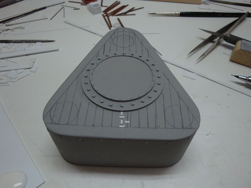

Starting to plan out the linings for the non slip decking.
All lines marked out, including the space required for the siting of the armoured perescopes.
Works well underway.
The rear side is ready.
Preparing to do the last piece.
The non slip flooring is ready - nearly seven hours of work.
A view of the non slip decking with the armoured perescopes in place.
The first base coat.
A general view.
A rear view with the radar in place.
I shall try to post more pictures today.
Cheers.
Paul. :ahoi:

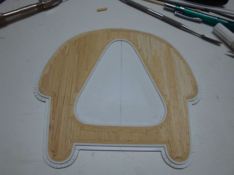

Dienstag, 2. Oktober 2012, 09:04

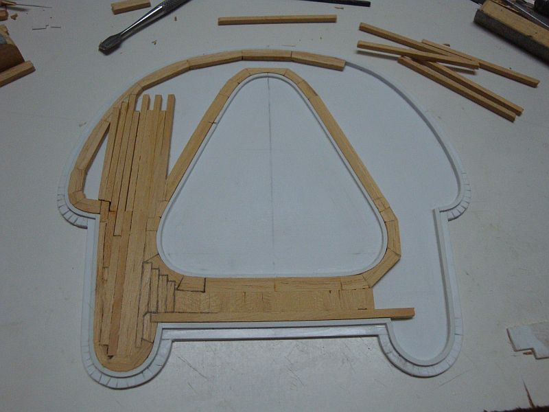

Hello my friends, :wink:

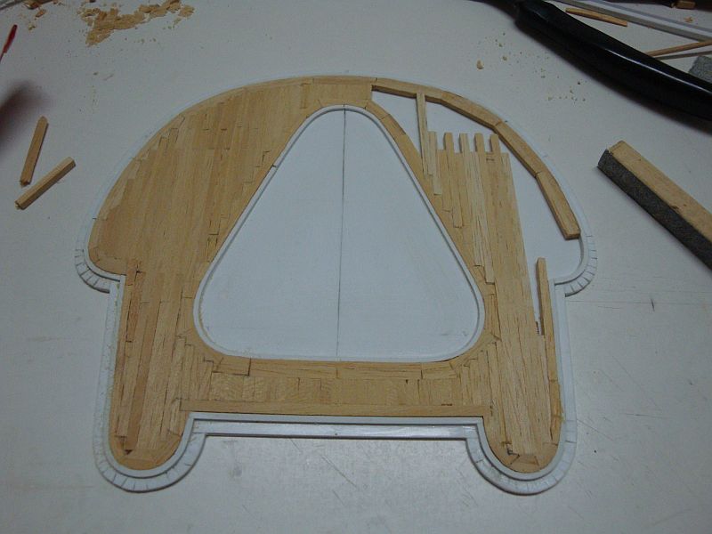

The progress pictures related to the planking of the open type foretop observation plaform.
Please don't laugh, this is my first planking job.
Cheers.
Paul. :ahoi:

Mittwoch, 17. Oktober 2012, 13:08
Hello all, :rolleyes:
Thanks for lookinh in Sergio, and for your kind comments.
Finally I found some time to finalize the wooden decking of the observation platform.
Below are some pictures.
I still have a lot of work to do, but the staining of the wood is already in progress. After that, I will have to carry out all the lining with a balck coloured 0.25mm permanent fine liner.
Cheers.
